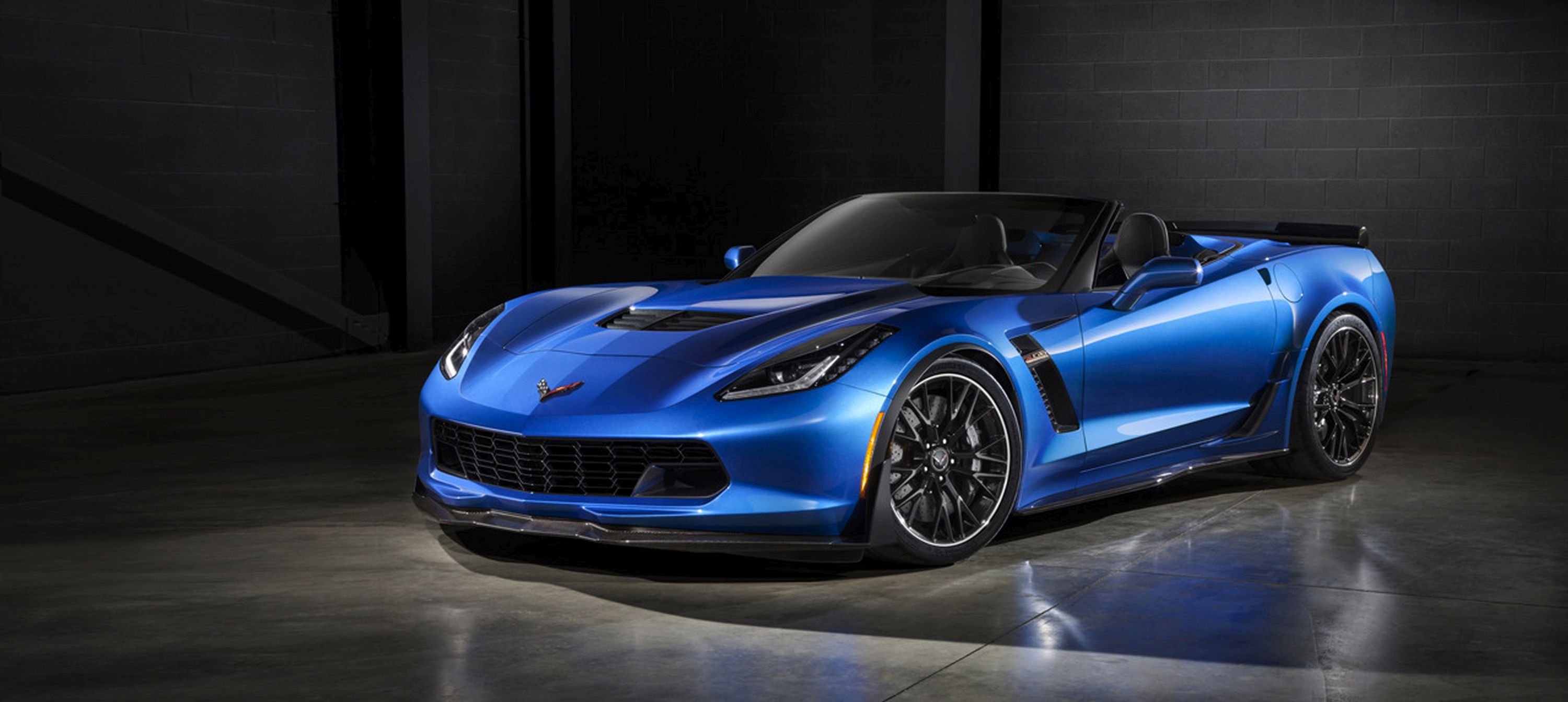

Chevrolet today introduced one of the most capable drop-tops on the market: the 2015 Corvette Z06 Convertible. With at least 625 horsepower, and 635 pound-feet of torque, the Z06 is also the most powerful convertible ever produced by Chevrolet.
“The Z06 Convertible is a world-class supercar in every sense,” said Mark Reuss, executive vice president, Global Product Development. “Only a handful of convertibles in the world bring more than 600 horsepower and 600 pound-feet of torque. Even fewer can match the advanced technologies, aerodynamic design, and visceral driving experience of the Z06 Convertible.”
This is the first Z06 Convertible offered from the factory since 1963 when the Z06 option package was introduced for endurance racing. Records show only 199 Corvette orders with a Z06 package that year, including one convertible.
Recent technological advancements enable the building of a modern Z06 Convertible, said Corvette chief engineer Tadge Juechter
“Until recently it was not possible to create a lightweight, open-roof structure strong enough to cope with the braking, cornering, and acceleration of Corvette’s top performance models,” Juechter said. “The frame for the Z06 convertible leverages advancements in computer-aided engineering, metallurgy, and manufacturing techniques – many of which were not available just five years ago.”
The aluminum structure is 20 percent stiffer than the previous, fixed-roof Z06. As there are no structural reinforcements needed for the Z06 Convertible, its curb weight is nearly identical to the Z06 Coupe. They also share the same chassis tuning, powertrain output, driver technologies and equipment options – including the Z07 Performance Package, which adds Brembo carbon-ceramic matrix brakes, Michelin Pilot Sport Cup tires and adjustable front- and rear-aerodynamic components.
“The most impressive aspect of the Z06 Convertible may be its performance bandwidth,” said Juechter. “Very few cars on the market can match its combination of extreme, supercar levels of performance; the flexibility for daily driving and long-distance commuting; and the 360-degree, open-air driving experience only true convertibles can offer.”

Like the structure, only minor design changes distinguish the Z06 Coupe from the Convertible. The Z06 convertible features an electronic top that can be lowered remotely using the car’s key fob. The top can also open or close on the go, at speeds of up to 30 mph (50 km/h).
With the top up, the Z06 Convertible is designed for a refined driving experience. A thick fabric top, offered in four colors along with sound-absorbing padding and a glass rear window, contributes to a quiet cabin and premium appearance.
Behind the seat backs, dual accent panels – either Carbon Flash-painted or available with exposed carbon fiber – enhance the character lines of the tonneau cover. Corvette Stingray’s signature “waterfall” design originates in the valley between the nacelles, bringing the exterior color into the interior.
The power-operated tonneau cover necessitated moving the air intakes for the differential and transmission coolers from the rear quarter panels on the Z06 Coupe to the underbody of the Z06 Convertible.
Otherwise, both models share the same, performance-driven aesthetic.
“Practically every exterior panel serves a functional purpose to meet the performance goals of the Z06,” said Tom Peters, Corvette design director, “The flared fenders accommodate larger, wider wheels and tires for more grip. The larger vents provide more cooling air to the engine, brakes, transmission and differential for increased track capability. The more aggressive aerodynamic package generates true downforce for more cornering grip and high-speed stability.”
Both Z06 models are fitted with Michelin tires (Pilot Super Sport tires for the Z06; Sport Cup 2 tires with the Z07 package): P285/30ZR19 front, and 335/25ZR20 rear.
The tires are mounted on lightweight, spin-cast aluminum wheels (19 x 10 inches in front and 20 x 12 inches in the rear). Their open, ultralight design showcases the massive Brembo brakes, which contribute to the design:
· The Z06 features two-piece steel rotors, measuring 14.6 x 1.3-inch (371 x 33 mm) front and 14.4 x 1-inch (365 x 25 mm) rear, with aluminum six-piston and four-piston fixed calipers, respectively
- The Z07 package adds larger, 15.5 x 1.4-inch (394 x 36 mm) front and 15.3 x 1.3-inch (388 x 33 mm) carbon ceramic-matrix brake rotors for consistent performance lap after lap. They collectively save 23 pounds over the standard Z06 rotors.
Both Z06 coupe and convertible will be available with one of three, increasing levels of aerodynamic downforce:
- The standard Z06 features a front splitter, spats around the front wheel openings, a unique carbon-fiber hood with a larger vent, and rear spoiler
- An available carbon-fiber aero package delivers aerodynamic downforce four times greater than the standard Z06. It adds a carbon fiber front splitter with aviation-style winglets, carbon fiber rocker panels, and a larger rear spoiler with a fixed wickerbill – a small, vertical tab at the edge of the spoiler that significantly increases downforce. The package is available in black or a visible carbon-fiber finish
- The available Z07 package adds larger winglets to the front splitter, along with an adjustable, see-through center section on the rear spoiler enabling customers to tailor the aerodynamics to their preference.
Compared to the Corvette Stingray, the Corvette Z06 fenders are 2.2 inches (56 mm) wider at the front, and 3.15 inches (80 mm) at the rear. Those extensions give the Corvette Z06 a wider, lower appearance further emphasized by a unique rear fascia. It incorporates the same taillamp assemblies as the Stingray, but on the Z06 the taillamps are pushed approximately three inches farther apart, toward to edges of the body.
The exterior design also reflects the increased cooling required for the new Corvette Z06. For example, the mesh pattern on the front fascia was designed to deliver the most possible airflow to the supercharger’s intercooler heat exchanger, so much that the mesh grill directs more air into the engine bay than if the grille was removed.
The unique grille also features dedicated brake-cooling intakes and wider grille outlets on the bottom serve as air diffusers. A larger hood vent allows air driven through the grille to exit through the hood rather than being forced under the car, which could create lift.
Standard front and rear brake-cooling ducts, including Z06-signature rear ducts integrated in front of the rear fender openings, are also part of the functional design changes.
