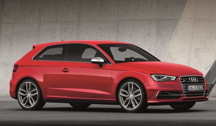

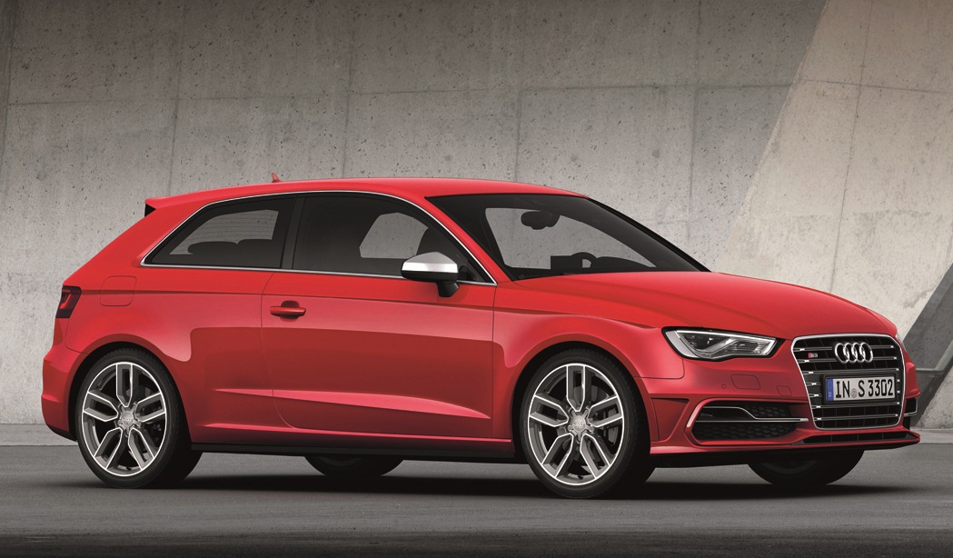

Whenever Audi releases a new “A” vehicle, its a safe bet that an “S” variant is soon to follow Such is the case with the newly announced 2013 A3 Sportback. To give the slick 5-door an extra dose of fun, two doors have been removed, and more power has been added to fill the void.
The new three door hatch oozes sex and performance, and Audi has not disappointed. The long list of fuel savers from the A3 have all been replaced with a new turbocharged 2.0-liter that pumps out 300 horsepower. Thanks to advances in weight savings and engine tech like direct injection , the powerhouse under the hood also manages to sip fuel providing a 30+ mpg rating on the Euro scale.
Transmission include a six-speed manual or Audi’s long standing S tonic auto. Buyers who opt for the manual will lose a few tenths to sixty, but gain a few MPGs. Part of the MPG gain is thanks to weight, as the manual has a lightweight magnesium-alloy casing.
All that power and weight savings translate to a o-62 claim of about 5 seconds. Regardless off gear choice, Audi says the full 280 lb/ft of torque is available from 1800 rpms all the way to 5500, so response should be great.
TO learn more about this cool looking car, check out the full press release below, and be sure to look through our amazing gallery of high-resolution photos.

Exterior design
The new Audi S3 has a firm and sporty road stance. Each element of the design is precise and distinctive. The athletic sculpture with the low engine hood, the characteristic tornado line below the windows and the sharply sloped C-pillars stretch the body visually. Audi supplies xenon plus headlights with LED daytime running lights as standard. The flat rear lights, into which the adaptive brake light is integrated, are also fitted with light-emitting diodes.
The xenon-based Audi adaptive light swivels into curves. It is also linked to the navigation system and can be upgraded with special lighting functions of urban, interurban and highway driving, as well as for intersections and tourist attractions. When combined with the front-facing camera, the light-dark boundary of the headlights is automatically and steplessly adjusted for substantially improved visibility and safety.
A true first in the premium compact class are the optional LED headlights, which previously have only been available in full-size models. The low beams are generated in two free-form reflectors with a total of nine high-performance LED chips. Ten high-performance LEDs in the matt aluminum trim provide the high beams. Depending on the features chosen, the high beams are switched on automatically and LED cornering lights illuminate tight corners. Interurban, highway and tourist attraction lighting round out the lighting convenience functions. The all-weather lights enhance safety in fog or snow.
The Audi S3 sports the S-specific single-frame grille as a symbol of uncompromised sportiness. The frame has an aluminum-look finish, and the insert is matt platinum gray. The horizontal double bars also shine in an aluminum-look finish. The newly designed bumper features aluminum-look double ribs integrated into the lateral air inlets. Pronounced edges frame the large air inlets with the high-gloss black honeycomb inserts. Additional implied air openings are found toward the wheels.
When viewed from the side, the aluminum-look exterior mirrors and the pronounced side sills catch the eye. The rear bumper has also been redesigned. The platinum gray diffuser houses the exhaust system’s four oval tailpipes, which sport chrome tips. A large roof spoiler generates downforce on the rear axle.
S badges adorn the rear and the single-frame grille. Highlights among the 14 colors available for the Audi S3 are the exclusive crystal-effect finishes Panther Black and Estoril Blue.
